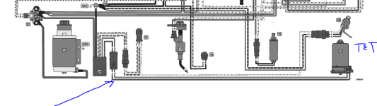

Crosbyman
Nov 5, 2006
6,233
see typical wire diag for t&T motor connection and access to connector from relay box
