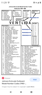

i have a 89 johnson tracker 20hp that is in need of upper engine mounts. so when im looking for the parts some sites ask if its 15 or 20 inch. im curious to wha they are refering to?
TJ20CRLCEM is the sn​
#11 is the mont im looking at

Your model number has an L in it. That refers to Long or 20 inch

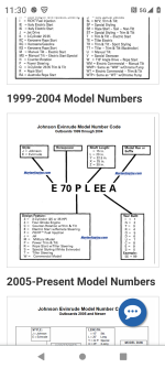

Here you go. Looks like you have a counter rotator

No that's the correct one they been using it since 1980. If you don't believe me just ask racerone.. He knows everything. Just disregard where it says 1999 through 2004 models.
