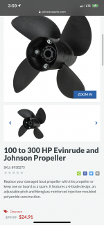

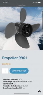

Anyone use these plastic props? Sweden made, rated for 300hp!!!!
$22 at Princess auto in Canada (kinda like harbour freight)

used them when they first came out, broke the blades and cut my foot on the pieces when I went swimming at the dock. YMMV, for $22 would at least make a good backup prop

Seems similar to the Prop Pulse Props made in Sweden, if so, what's nice is that can adjust the pitch in various sizes, excellent for : if varying loads, faster hole shots, pulling skiers, cruising ,etc. The down issue is that blades are hardened composite plastic, will break if hitting hard against something out or underwater. What's cool is that can buy extra blades as spares, remove the broken one, install a new in and keep boating....
