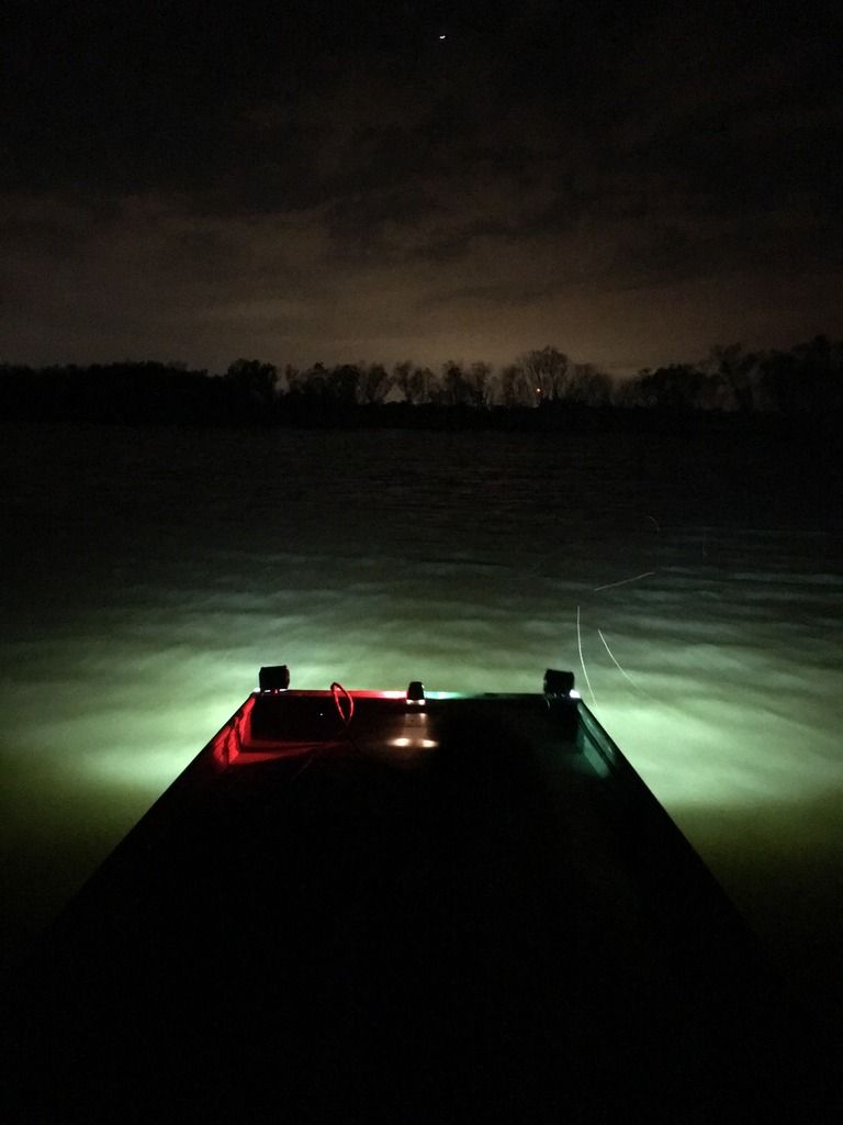

My fuel consumption was alot less that originally figuredsome pics of her lit up at night and from the lake today,including thousands of coots and my fishing hole....a hotel duckblind.
