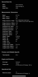

I just bought a 23’ Harris 230 royal heritage with a Honda 135 4 stroke. No lifting strakes. It plows terrible in the rear. The back deck rail is almost at water level. It runs about 23mph with 2 people. I found a 17’ toon that is the same diameter for $800 on Marketplace. That should cover the area in front of the motor pod. I was thinking of underskinning and throwing this third toon on it at the same time. I’m not looking to go 40mph, it just seems it should be up out of the water a little more than it is. Does this sound like a solid plan? I’m no pontoon expert. I’ve ran center consoles for years and this is my first toon since I was a kid. What say you experts?

The specs

You've got way too heavy a motor on that boat, even with the 25" 'toons.
If you add a 3rd toon forward of the engine pod, you may carry the weight better, you may not. The back of the boat is where you need the lift. A 3rd log may be too far forward, unless it's designed to replace the engine pod with a new transom.
The 135 Honda and a boat that size are just not a good match. I would be looking for a different motor, or a tritoon hull. There's a very good reason you are not going to see many conventional 2 tube pontoons powered by a 135 Honda. The biggest are usually the 90 Honda, and the 115 Mercs and Yamahas - all weigh about the same, and pretty much max out 25" pontoons for their ability to carry the weight. Even those motors are pushing it....
We have 1 boat on our (pretty good size) lake with a motor that size on a 2 tube pontoon. It's a 28' boat, and I beleive it was originally I/O powered. Huge toons. Maybe 28".
Your 130 rating is about a 4 cylinder 2 stroke. A 4 stoke is way heavier. If you go 6 cylinder 2 stroke, THAT motor will be too heavy!
