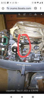

This is the nutruel lockout mechanism. There is an adjustable rubber stop tied into it.

Forgot the picture and it wouldn't let me edit.

Yes, motor works quite well actually. Looking at what you circled, are you referring to that screw? I don't see anything rubber, maybe it's missing, but I'm hesitant to move the screw as it doesn't seem like it would have any affect on that cam. Or the tab that rides on it. I'm temped to try to bend that tab, as that would definitely make a difference, but it looks like a stout part and not something that you should adjust.
Going back out to look for the rubber piece. I'll try to get some better pics. Thanks for the help.

That screw in the picture has to do with the lock for the starter.----Recoil should only work with motor in neutral.-----Do not adjust anything on this motor if you are NOT sure of it or the results !!!
