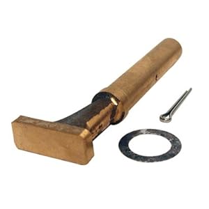

where is the intermediate shift shaft and the upper shift shaft?
The intermediate shift shaft is usually the one that gets bent when you remove the outdrive without being in forward gear. It is pictured here:
It sits in the outdrive and mates with the "shoe" in the transom assembly. Everything needs to be in forward gear as that puts the shafts straight forward, fore and aft, and allows the outdrive to come off. You can separate the two halves of the outdrive and remove the intermediate shaft easily and see if it is bent.
