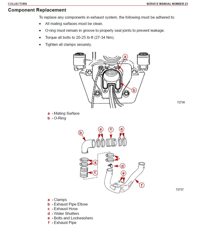

Ayuh,...... If it's an Alpha, there IS a y-pipe flange at the bottom of the transom housin', just above the trim lines pocket/ passage,.....
One of these is bolted in-place,....

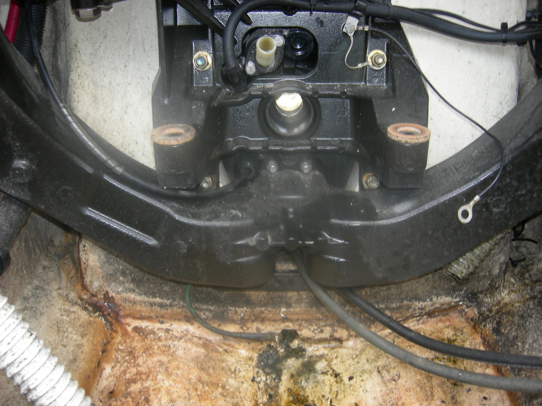

all alpha and bravo transom shields have a place for the y-pipe.

Yes, my drive does indeed have the hole for the exhaust bellows. But the transom does not. It only has the hole for the drive shaft. Am I missing something?
If you have an Alpha drive then you have what BT has shown, its part of the transom assembly and the hole has to be cut out for it. There is just a flat plate covering the hole currently

Sweet! The boat is in storage right now so I can't run out and look at it. So, is there a blank plate on the water side also? Isn't there a bellows that basically connects the transom flange to the drive upper? Sorry if that's a dumb question.

The block off plate is on the engine side
The exhaust tube or bellows connects the inside Y pipe to the outdrive

I think I get it now. I was thinking there were two separate transom holes for drive shaft and exhaust. But there is only a single large hole that the gimbal seals up. And the inside plate seals off water coming in through the unused exhaust port. So I just need the Y pipe to connect there. Please correct me if Im mistaken.
Correct
So if that be the case, is there anyway to "horse shoe" the Y pipe in and under the drive shaft without pull the engine? I'm sure I already know the answer but I gotta ask.
No way I have ever heard of someone doing it without removing the motor. It's just to tight
Nope,...... I doubt you can even reach the bolts holdin' the block-off plate,.....
