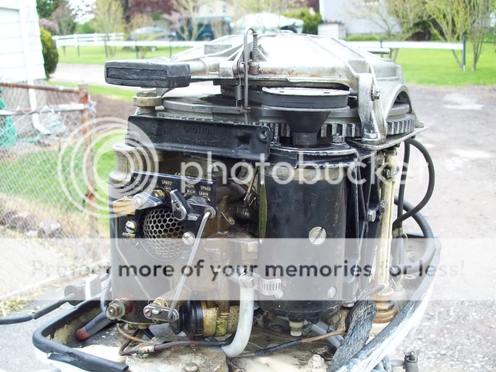

Just a few pictures to show you all what I am working with. Mind you there were no seats or accessories in the boat prior, also I added that bilge pump with the thru hull fitting. Not bad for trading an 80$ .22 rifle for a side by side shotgun for what you see here

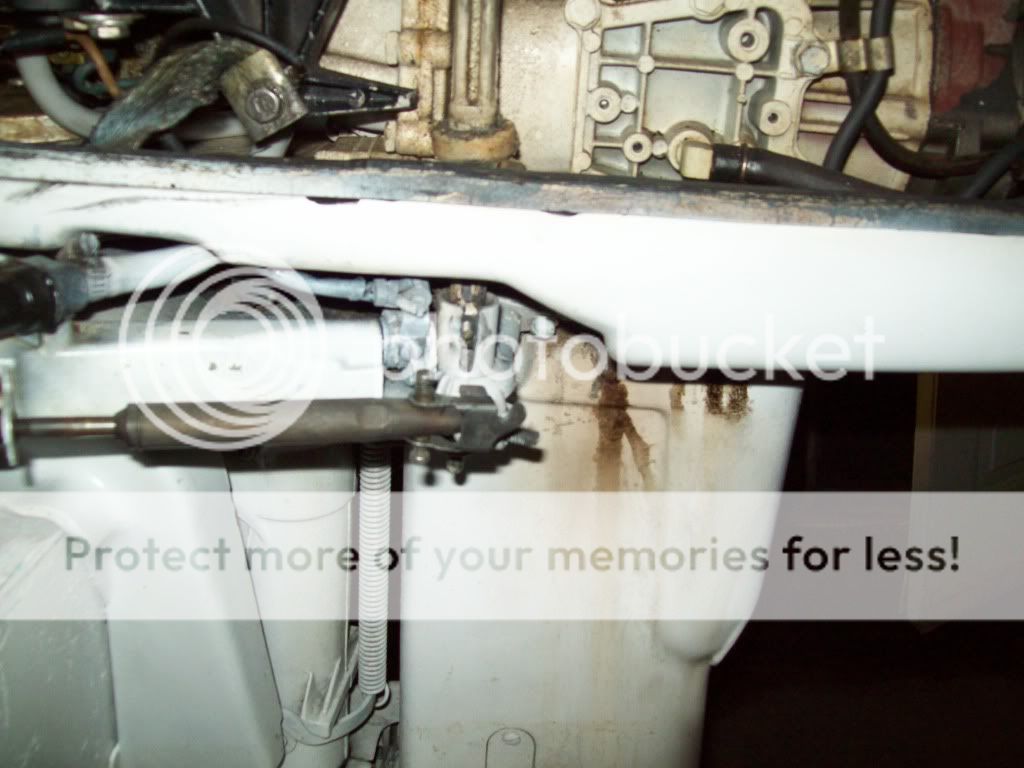

OK so were still making some head way. The choke wasnt on or anything i was using the electric choke so it was on or off. But i found a linkage problem! So lets use my hip-bone connected to the leg bone descriptive skills. For lack of better terminology the throttle is connected to these 2 gears that connect to some long vertical pole that hooks to the throttle cable. Well on that pole there is a pin that sticks out of a key way of the gear so it doesnt slip, that pin was broken. So I pushed out the remaining piece of plastic, drilled a hole thru it, and fit a stainless 10-24 machine bolt thru it and cut it to length. here are 2 pics that show what i cant really elaborate haha.
This is it fixed
Maybe that is why I was not gettin Full Throttle?

Could easily be. Look in the carb throat with the throttle in the wide open position. The throttle butterfly, behind the choke butterfly, should be absolutely horizontal.

Well on that pole there is a pin that sticks out of a key way of the gear so it doesnt slip, that pin was broken. So I pushed out the remaining piece of plastic, drilled a hole thru it, and fit a stainless 10-24 machine bolt thru it and cut it to length. Maybe that is why I was not gettin Full Throttle?
Great find! FYI, I believe that plastic (nylon) pin is p/n 0304155 (may be superceded) which should still be available because it was used on many millions of OMC motors. Also, it has flat "ears" on both sides for maximum contact in the gear slots. You made a good fix but your SS bolt is much harder than nylon and may damage the aluminum gear. Check the armature plate for easy movement and lube the linkage good. Gotta think it's close to being right now!
EDIT: As suspected, p/n is now 0329197.
