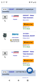

11 & 12 If I pull down water tube to check grommet will grommet come down with tube? How hard is it to replace grommet?

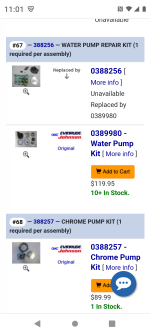

Rebuild the water pump with an OEM kit and replace everything.
