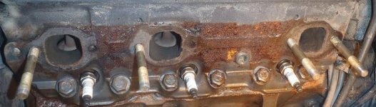

The heads have to come off. Both pics show evidence of water leaking in from the exhaust or other sources and you have either bad valve seals and/or guides.
Here’s a pic of my old engine when I had the manifolds off to change them. At the time the engine was 23 years old used in salt approx half of that...4.3 exhaust ports and exhaust valves.jpg
