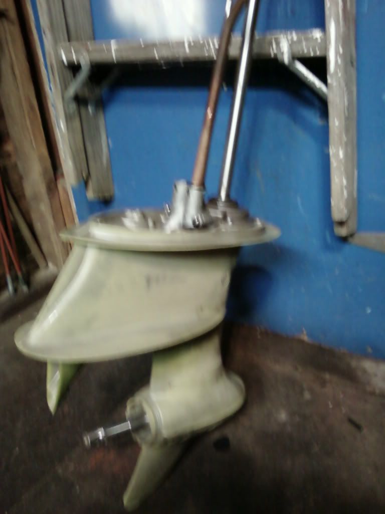

1946Zephyr
Oct 21, 2008
5,556
Re: 382918 Gearcase water tube configuration questions.
Well, I got it all together last night and this is what it's looking like. All I need to do, is purchase a return line. I may just go to Gormley Plumping and pick up a piece of copper tubing and make my own. They only want $20 at marineengine.com, but a piece that long should be less than half and I don't have to pay shippin'
