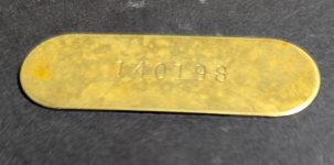

I bought a boat, knowing that the engine was not winterized. It is the 4.3 Chevrolet V6. I have swapped and rebuilt a few of these engines, so I'm very familiar with them. While the engine was still in, I had it running with water connected. I noticed that the freeze plugs popped, and both the manifolds had cracks. So I pulled the engine out. I saw that it did not have that little plate on the block with the serial number I'm used to. I found a different little plate attached to the engine. I'm attaching a picture of the plate because I'm wondering what it represents.

Here is the image of the plate on the engine. The number is 140198

tag probably means it is a rebuild.

Also checked the pistons and they are .40 over so it is a rebuilt engine.
