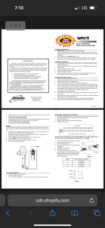

Current distributor is a mechanical advance and was designed to only advance 12 degrees from idle timing making total advance 18 degrees when idle is timed to spec of 6 degrees.IMG_3259.jpeg

I think typically you see the 4.3 having less total timing than the 5.7, somewhere around 24 or so With vortec heads .
Due to the load on marine engines they are more detonation prone so comparatively you see marine ignition curves be more conservative in terms of total timing
what you outline should provide a nice increase in hp. the 4 bbl vortec engines are rated at 225 hp. Don’t go nuts with the timing and destroy the engine with detonation.
