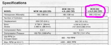

When I bought my new engine I have gone through many sites and all of them listed the Vortec with 4bbl at 205 hp. Only the one with the roller rocker arms was always listet with 220 hp. I guess only the rollers can not make this difference so maybe something else was changes also on the heads or camshaft. I would be insterested in details if someone knows.
Then they are all wrong. 205hp was a 4bbl non-vortec. This is a screenshot from the 1983 to 1993 V6 manual. Definitely pre-vortec era.
After this, the manuals use propshaft horsepower and there is no direct comparison. All I can do it show the difference between the 2bbl non-vortec vs vortec and extrapolate that to the 4bbl. It equates to between 20 and 25 horsepower just by fitting vortec heads.

Yes, you are right. The mixture between crankshaft horsepower and propshaft horsepower is confusing.
My original 4.3 pre Vortec with 4 bbl was listed with 200 hp in the boat papers.

I’m a little confused reading this. LX meant 4bbl?
In pre-vortec, yes. When the vortec heads were put on, they change the designation to LH or LXH
So it is aging a PRE- vortec with 4bbl is 205 horse the. Your saying adding vortec heads with 4bbl adds another 20-25 horse?
Yes, that's exactly what we are all saying.
I’m am would like 200 or so horse and would be happy adding a 4bbl to my existing set up, changing heads will cost a pretty penny
To add a 4bbl, you need to buy a new manifold anyway. So just add the heads and buy a vortec manifold instead of a non vortec. Even brand new vortec heads aren't that expensive.
In the above picture, 'Gen II' is the engine, not the drive, and means balance shaft. 'Gen+' is for balance shaft AND vortec heads.
