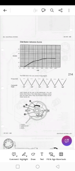

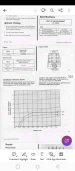

I have a 4.3l mercruiser with a prestolite distributor. I understand that it should have thunderbolt but instead has points. Timing spec says it should be 8⁰ BTDC according to manual for thunderbolt. Total timing at 22⁰. What is confusing me is that with aftermarket HEI distributor with 22⁰total. My boat falls on its face and wont plane. However if i install the points back in, 8⁰ BTDC i get 32 ⁰ total advance and i have lots of power. According to the manual i have, v6 mercruisers with points should run 12⁰ base and 20⁰ total advance. How can the same engine have such different advance needs depending if its points or HEI. Im not trying to blow up my engine or melt pistons. Im only digging into this because my distributor is falling apart and if i cant get it rebuilt, i will need to find a replacement with the correct timing curve. So i guess my question really is. What should my timing actually be at base and total without melting my engine?

12 degrees of base timing plus 20 degrees advance is 32 degrees. That's how math and timing work

Agreed. Just the first graph doesnt state that. Which is fine. Is what it is. I just don't understand how hei vs points changes total timing by 10⁰. Engines shouldn't care what or where the spark comes from. As long as it sparks when it should. Im likely overthinking it. But i dont want to cause damage
