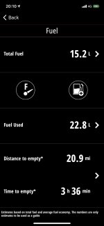

Excellent. You won’t regret getting this for the boat. Total game changer for sure. Brilliant for getting your boat propped well too. With the rpms and speed being pin point accurate too.
But most useful for me is it telling you the range left you have at the speed you are currently doing. So you can then work out exactly what your best cruising speed is. Might surprise you. It did for me.
