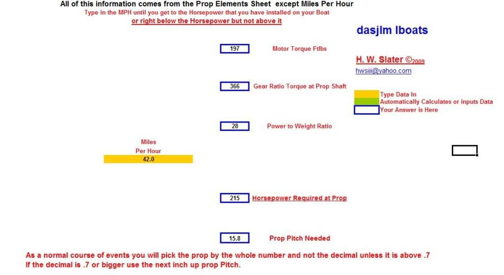

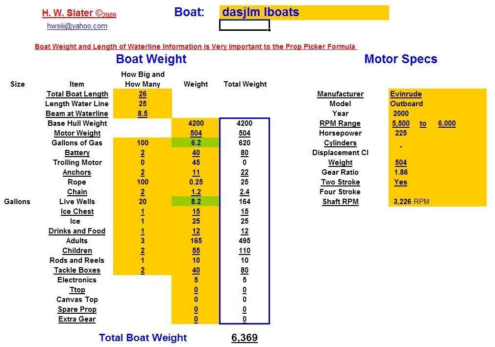

I'm considering upgrading to a 4 blade ss prop for my 1998 striper with a 2000 225hp envridue fitch ram.
Recommended RPM: 5000 - 6000
# of Splines: 15
Gear Ratio: First: 1.86
I'd like to get on plane a bit faster and have reasonable fuel economy at mid speed. I'm not concerned about top end speed.
The boat is pretty heavy so I'm thinking a 4 blade ss prop 15" diam and 15 pitch might be reasonable.
Anybody have any comments/suggestions?
Thanks in advance
John
