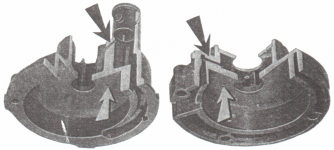

I am replacing the water pump on a 4 HP Evinrude. I believe the year is about 1969. It's a direct drive. You can see the lower unit below. Of the two screws holding the impeller casing down, one came out easily. the other was missing the head. With one screw out and one missing the head, the impeller casing should lift off but mine is stubborn. I don't see a slot to pry it. Should I grad within the slots by the drive shaft and attempt to pull it? Any tricks to remove this stubborn component. I don't think I need to easy out the broken screw to get this cover off. Buster7 4 HP Evinrude Water Pump.png

don'T forget...
Crosbyman, What are you trying to illustrate? The cutaway view shows a small passage just under the riser tube connector. Anything I need to free or loosen before I try further to separate the impeller casing? Buster7
just clean out the passages when reinstalling the pump cover
