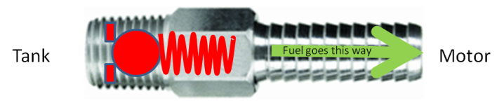

Hey, thanks for the cool pitcutrre!........ No barbs on mine...... 1/4 NPT on both ends.
I somehow answered the question on my own and believe it or not... all three oriented and installed true to your picture.
So......I continue to be experiencing high power throttle RPM roll backs on both port and star. The original school Fram water separators were identified some trash in bowls. I then installed all new Mercury style fuel water separator housings and elements. I using all Mercury (Not Quicksilver) housings and black mercury water separator elements. Original anti-sphone valves reinstalled. See trial on Friday
