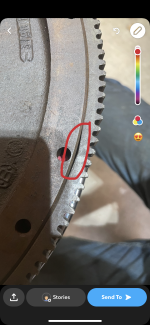

Awesome I’ll double check all of those tomorrow!!! The rebuild was professionally done by a shop.I believe it is original dampener and reused coupler. I pulled the motor and took the fly wheel off and noticed it was a little warped but I’m not sure if it’s enough to cause harm. I’ll post a pic.

look at your receipt. what did you pay for? a balance job is an additional $700+ charge
regarding your damper. use a piston stop and a degree wheel. verify that the damper ring hasnt slipped.
the flywheel ring gear is fine. you would not feel that dent. if it bothers you, get a new ring gear from your local parts store and swap it.

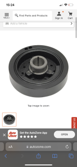

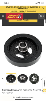

Sooooo after further investigation. I believe that someone may have switched the balancer on the left with the one on the right.
Trevordakid
Nov 8, 2023
23
I got a 454 gm mercruiser or whatever u call it. Older model Mark IV 454 I believe. I bought recently and it has been shaking around 3500 rpm. I have looked at the harmonic balancer and noticed it does not have a weight on the inside. Do all 454s have weights in the harmonic balancer. Picture on the left is what I have on it now and the picture on the right is what I’m referring to. Could this be the cause of the vibration? Any feedback helps :)
kenny nunez
Jun 20, 2017
3,497
The un counter weighted balancer is probably from a small block engine that are internally balanced. A good thing that you found the problem.
