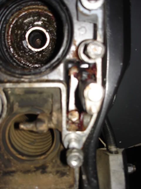

Another issues when I pulled the drive off today ,it takes a bit of tugging ,unlike a merc there was a little bit of water in {see photo } not much .The two (2) things I think I did wrong I I did not have the OMC book at that time I have it now no gasket sealing compound on the out side of the out drive drive gasket facing the outdrive and no gasket sealing compound on the front of the joint bellow where it attaches to the pivot housing . Any way ,can water come in any other way I would think if it leaked it should keep on leaking .
