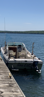

I was advised by others to join this thread as there have been lots of information of swapping a 190 to a 4.3. Based on discussion I’ve heard it can be fairly straight forward as it should pair with the outdrive and the stringers on my ‘85 Chris craft scorpion 215 “should” along to hold the v6. The hull/boat is in great shape and I think it is an opportunity to put in a little more power. Looking for advise/tips/ links to prior conversations regarding this topic - thanks in advance. I will also be interested in where to locate a remanufactured engine and a mechanic in the Midwest that would consider this project. Cheers
