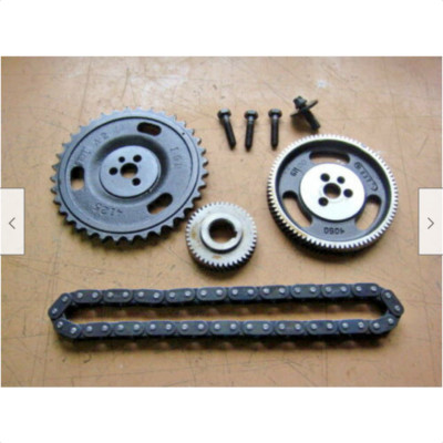

Do a quick search of GM 5.0L "Reluctor Wheel" 24x or 58x... Black (24) or Gray (58) Crank shaft Sensor which is part of the timing system in which could be an possible issue.
1997 chevy silverado
2005 vp 5.0 gxi

You're right at the line making it hard call to say for sure.
VP crank sensor 3858979, https://www.ebay.com/sch/i.html?_fr...acat=0&LH_TitleDesc=0&_odkw=3852690&_osacat=0
