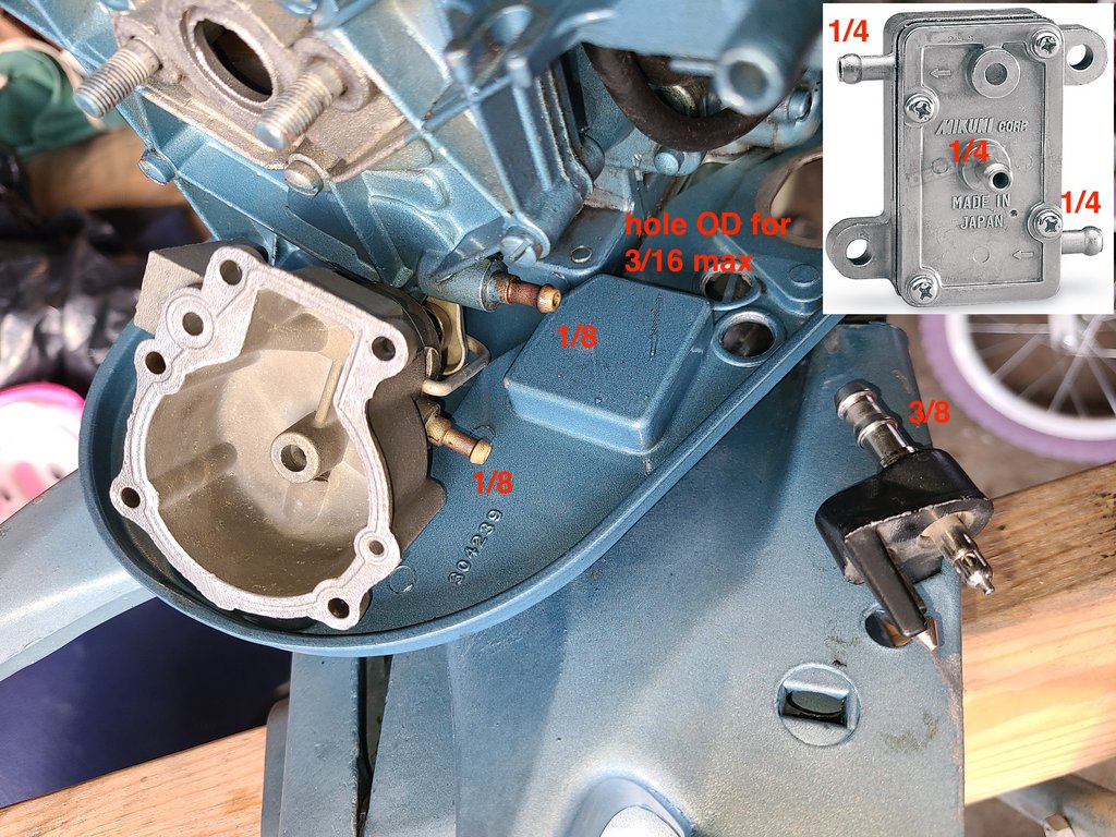

Alright folks......I'm almost ready for reassembly and I have a few issues I need feedback on. The manifold and carb nipples are for 1/8" hose, the Mikuni pump has 1/4" hose nipples, the fuel connector has a 3/8, AND the hole in the cowl plate that the hose has to run through is for at best a 3/16" hose. How do I make all these agree with each other without getting crazy with a bunch of double barb reducers and more and more clamps (for leak points)?

Could I at least clean up the exterior by using a connector like this with a threaded portion and then using a barb to reduce it down to 1/8 hose so could go through one of the cowl holes? Does anyone know if these threaded connectors had NPT threads?

what I have done in a similar situation is I simply added an extra inline filter
which had barbs for 2 sizes it allowed me to connect the fuel source on one side .......then the thinner barb was used to feed the carb . extra filtering won't hurt anyway
as to the pressure out nipple ...... to the mikuni the 1/8 hose can usually slip on the 1/4 nipple with a bit of oil or grease .... warm up the hose to soften it up on the 1/4 nipple
39,015
You can not use that nipple ( as is ) on the intake manifold to run that mikuni fuel pump.

Nice observation (the manifold screws are still factory painted over and have never been off)....I fibbed a little as I'm not exactly ready for reassembly, I still have to seal up one side under the manifold and take out the check valve system. Thanks for looking out.

It ran perfect when it went into storage in 2004 and has all kinds of compression. Its my childhood motor so I'm getting it going regardless, if I had to replace the rings I'd replace the rings. The original tank must have took on some condensation and developed a small rust ring in the bottom 1/16 of the tank that turned into some pinholes. I bought a second tank that needed work too so I thought I might as well modernize it. If I have any problems with the pump system I can easily get it going with a gravity feed.
I just need to handle the different hose sizes with any sort of elegance. I'll try heating and lubing up some 1/8" fuel line and see if it attaches to the Mikuni (1/4) but that is a lot to ask for since the nipple is doubling the size requirement and not just off by a little.
