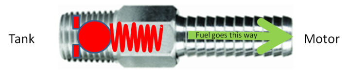

The AS valve is a barbed fitting connected to the tank pickup
Scott06
Apr 20, 2014
7,616
Thanks I have one but there’s nothing in it
so I’m sure this is my problem
Takes a little suction to open prevents fuel from siphoning out of tank into bilge if their is a leak …
Cheap part to replace and rule out
