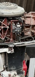

Is this the fitting you’re referring to? Or are you talking about a different component

The motor gas been converted to run with a fuel pump.----No need for the pressure tank.

For some reason I can’t get the pic of the pump to enlarge but does anyone else see a fuel line going to the pump?
There’s only one line. Apparently someone switched it to a single line system before I got ahold of it
