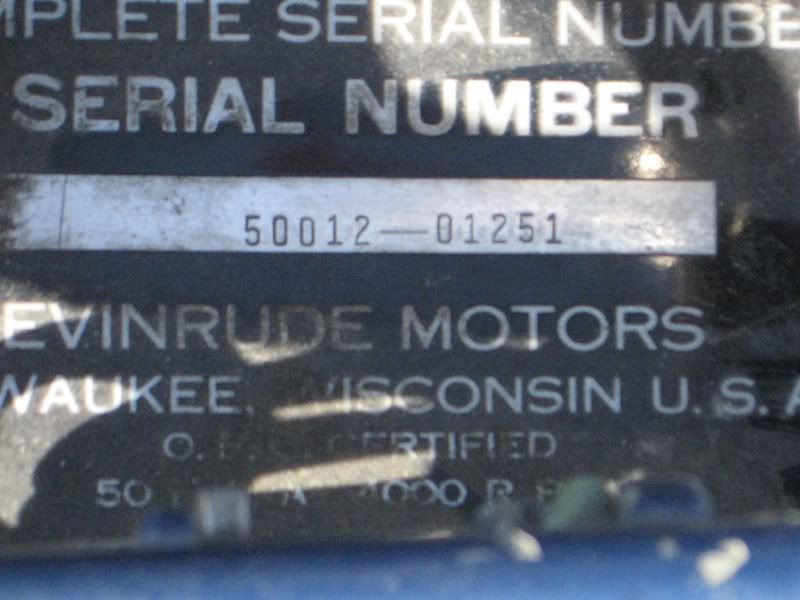

Steve, My buddy told me "five hundred twelve" over the phone. HE meant 50012.
Here's a photo of the motor plate.
Nothing has come through. The "09" in the email is zero 9, not "oh"9.
Thanks again:)
samo_ott
Jun 18, 2006
5,125
Re: '58 Four Fifty parts
Oh, it's the Evinrude... I was thinking Johnson... It's the Johnson one I have, but they should be virtually identical... it's 6gb... It's still sending! Might go overnight :) My 'highspeed' here in the country is not that high!

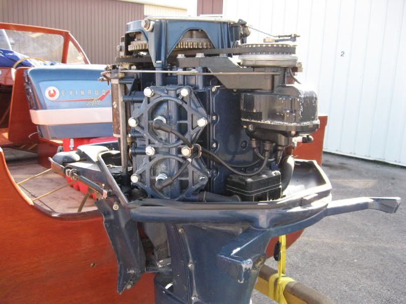

What is the black box under the distributor cap?
Verne;)
Evinrude Boater
Jul 6, 2004
1,144
That black box under the distributor is the thermostat. They crack if water freezes in them. You might see a calcium deposit where there's a crack; usually on the bottom. If you unscrew the screws on the top it will spring apart and you'll see two valves, the one on the port side with the thermostat or vernatherm.
