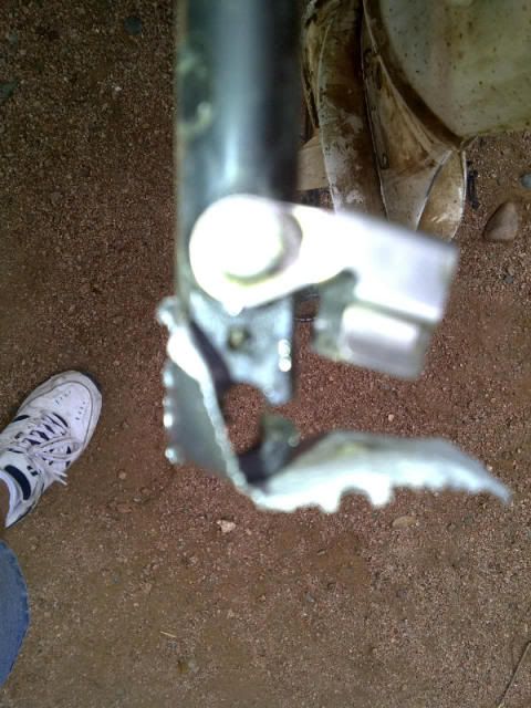

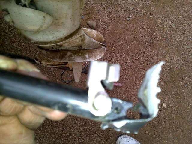

However, while trying to use the throttle cable that was with the boat, I guess the 40 year old plastic had had enough. When I went to put it on the Johnson, the hole snapped. You can see the break in these pics. I tried to JB Weld it (and Gorilla glue) and then use duct tape to let it seal, but as soon as I tried to put it back on the motor, it broke again.
Before I place the order for the Clamp Block, is there a replacement piece for the throttle end that I can also order? If not, I'll just use a piece of metal with two holes in it and utilize the screw that was holding the metal cap on at the end of the plastic throttle body.

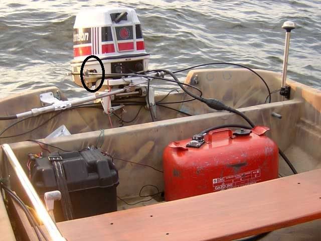

As I look at your picture, I see the clamp block is for the steering linkage. I can see that that will give me even better steering control than I currently have without it.
I had thought that the clamp block was going to be for the throttle. Right now, that is what I am struggling with - a way to lock down the throttle cable so that I can use the throttle control lever at the driver seat. In the picture below, there looks to be some type of clamp on the bottom part of the motor. What is that clamp? I'll save the pic, draw a circle around the part in question, and repost.
Ok here's that picture:
Since the little motor (not sure about the big one cuz I don't know the year) does not have a tilt tube, you'll need a clamp block http://www.iboats.com/Corrosion-Res...5764940--**********.611379388--view_id.192758
See the circled area - I need some way to mount the cable to the outboard:
