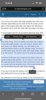

What ECU are you using for this engine ? I didn't think they offered 6.2 MPIs with an alpha (shift interrupt) compatible ECU.
I believe it’s using an Alpha ECU, but will have to double check.
I believe it is wired to ground the coil per this screenshot’s instructions.IMG_4655.png

I believe it is wired to ground the coil per this screenshot’s instructions.View attachment 411623
There is no alpha ecu for a 6.2 mpi, as mentioned in the screen shot you have to do a workaround to get a bravo ecu to work with an alpha drive.
if it’s wired like that then lit would make sense the lower shift cable is dragging and triggering the switch.
was that screenshot off the marine engine forum?
Have to agree with you, I have not been able to find an ECM for a 6.2 that uses a Alpha drive
Roger that about the Bravo ECU.
Could you clarify your latter point about the dragging.
Are you saying the lower shift cable is likely dragging/has resistance, and likely holding the switch down for longer than necessary?
Yeah the biggest engine they make with an alpha is the 350 mag mpi- 300 hp. i Think all the 6.2 s are 325 or 340hp .
prob closest way to get there is take. 350 mag alpha and reflash it for a 6.2 fuel curve
I think the work around it using a NC interrupter to cut off the signal from dist to coil or interrupt 12 v to positive side of coil
I think the work around you described is actually what was done on my engine, and outlined in the screenshot prior?
Yes what was described interrupts the triggering signal between the dist and the coil, will keep coil from firing
