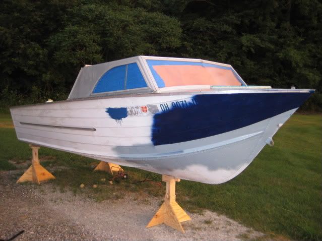

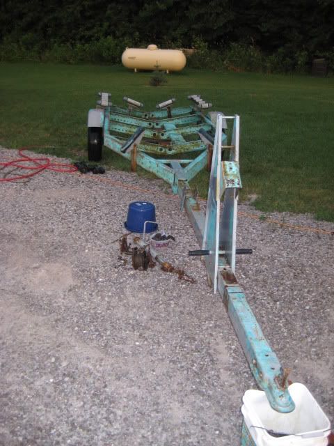

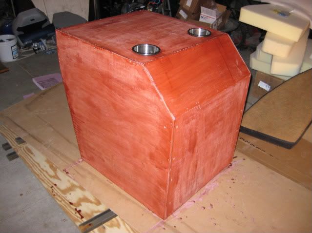

Here are some pics as of July 4, First, The new doghouse which will get covered in vinyl, the Boat on sschafers stands, and the trailer under disassembly.
I Kinda Like the three tone look on the trailer, maybe I should clearcoat it and call it done:D

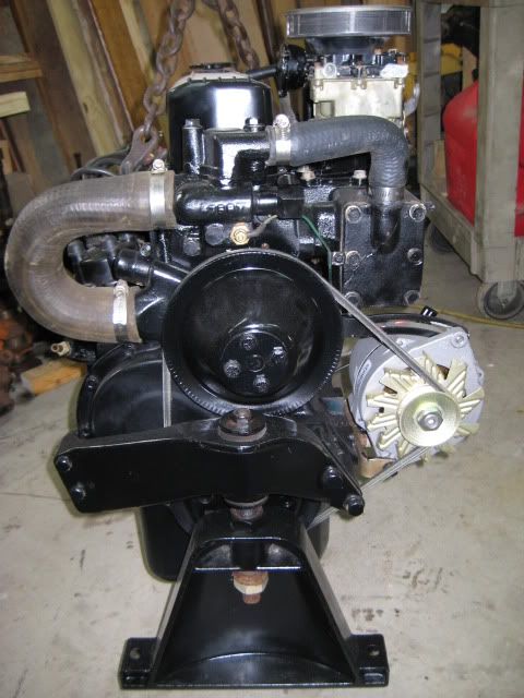

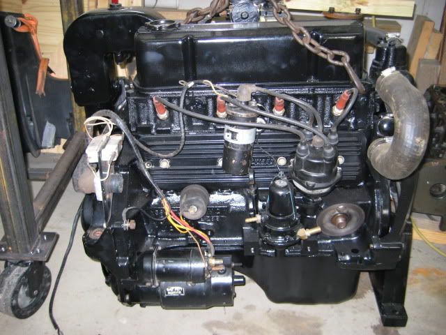

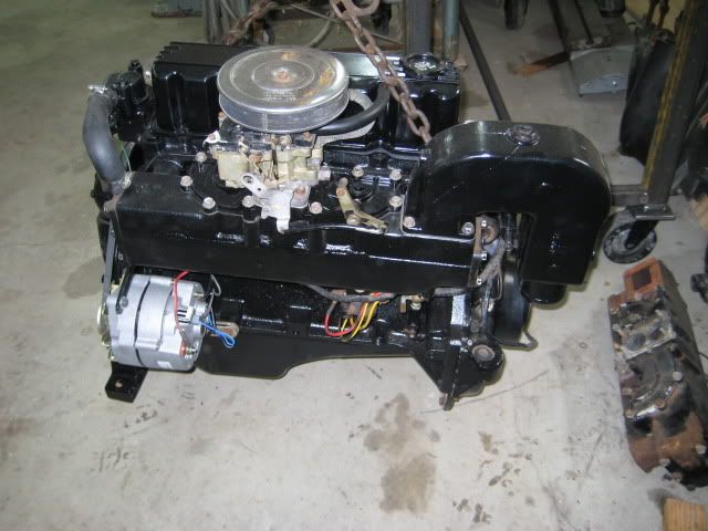

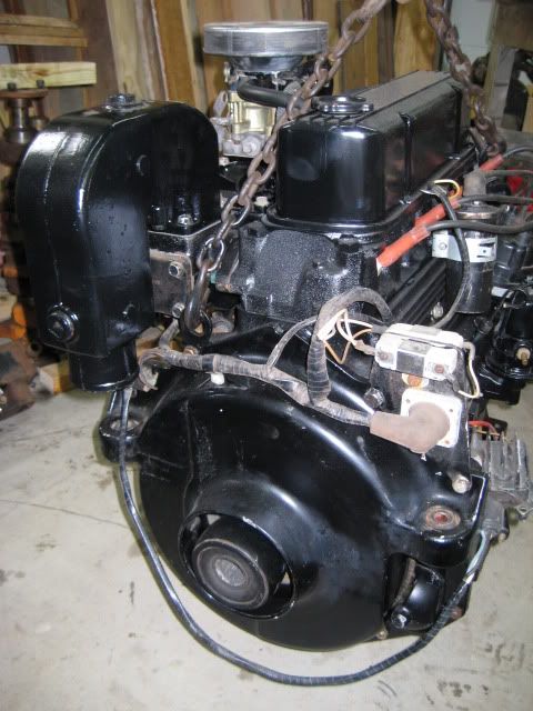

Here are some pics of the "old-new" engine ;)

Looking good! Doghouse looks great.

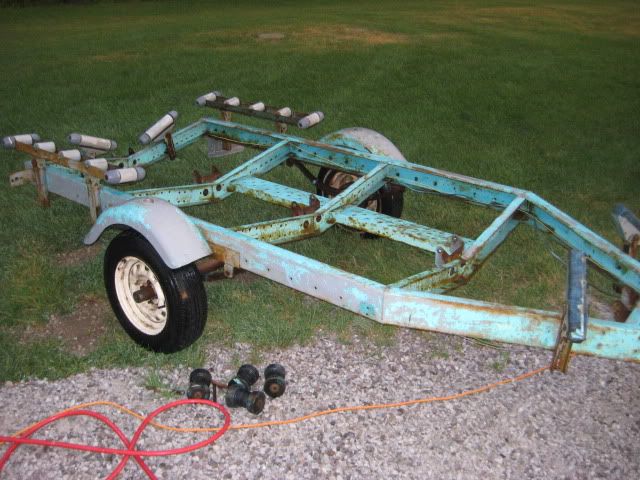

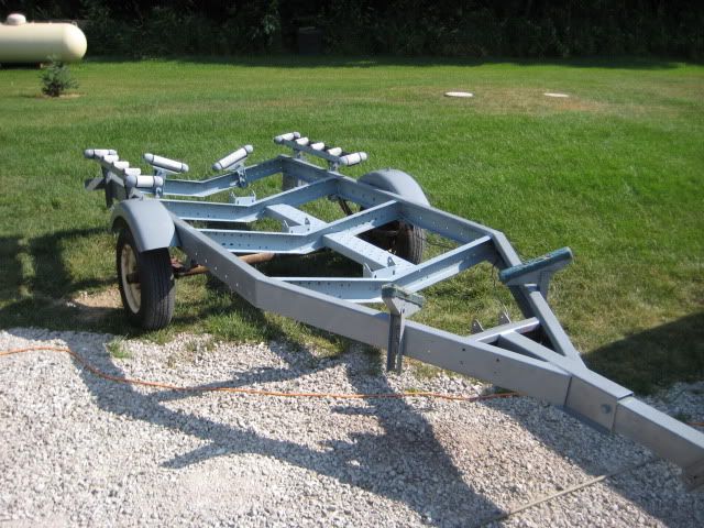

Trailer painting day! The weather was nice today so I gott out the rattle can and.....
I ordered some new keel rollers and a new strap winch from iboats.
I also started cutting the new side panels they are 8'-3" long so Iam going to have to figure something out, but the old ones were so rotted there was no re-using them. They are getting covered in Navy vinyl anyhow, so a joint is not really a big deal

Nice!!!!!!!!
should spray the axel too.
