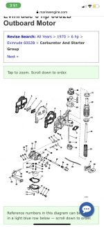

This is the diagram for my carb thinking I should just do a rebuild myself since the guy before me may have used cheap parts it looks like

I also have a 6 H.P. Evinrude that I had a problem with idling & starting after I rebuilt the carb with new, CHEAP parts. I rebuilt the carb a second time with OEM parts and it was a world of difference. The cheap parts that I put it were junk. The gaskets literally softened and became distorted from the fuel in the carb bowl. Replaced the cheap parts and I was all set. Runs great still after over a year ago.
