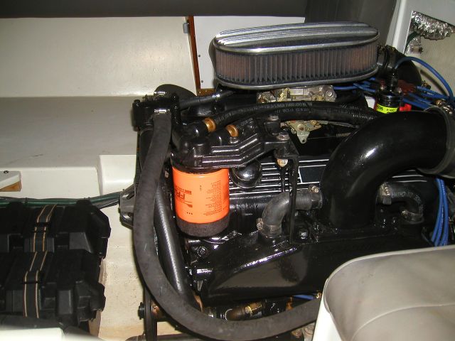

Here's what one side would look like installed on an engine,
http://www.supernova19.com/11b680e00.jpg
