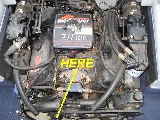

Newbie here been looking through the forum for information on this.So this is the situation i have a 89-90 chaparral 2350 sx with a 7.4 mercrusier so last week i went to turn it on i put on the mickey mouse ears turned on the water and proceded to turn the key it turned on was running and notice there was no water coming out the exhaust so no biggey truned it off and got a plastic barrell filled it with water and turned it on again seen the temps rizing and still no water was coming out the exhaust .
So i went and bought a new thermostat and changed it turned on still nothing and temps were rizing.So after reading this forum i read that it might be the water impeller? Were do i locate it on the 7.4 merc?And what whould be the part,kit number for the impeller for this motor?
Might this be the problem?Engine turns on fine revs fines but than reaches hot temps than i shut it down before it starts buzzing that it is hot.
Here are some pictures..Thanks for any help or any input on this ..Hoping to get this ready in 2 weeks so all help is apprciated..

The impeller IS NOT in the drive. It's located on the lower right side of the engine. The raw water pump is driven by the a fan belt.

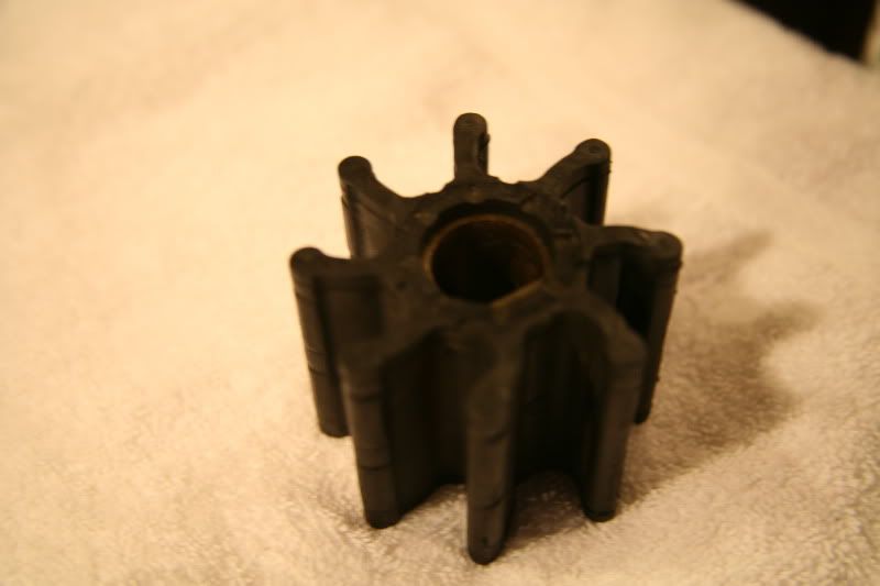

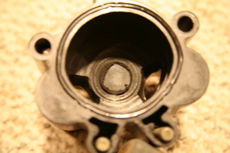

I ended up buying the kit glad i did, i did some more reading to figure out what is going on opened up the thermostat and it filled with water when it heated up the thermostat did its job and opened. Heared the buzzard of death so i shut her down , I started to remove the hoses and water poured out from there good sign i guess but no water out the muff, as i removed the water impeller housing i opened it up water came out and the impeller was in one piece :confused: did find the back of the house to be a bit damaged
and the impeller
Before the water stopped coming out the muffler and temps started rising, i started hearing a "thud thud thud thud thud thud" coming from the engine compartment than it went away and temps went up.
Were might there be something clogged?if it wasn't due to the impeller going out? im taking everything apart and giving it a good cleaning also inspecting what i find along the way and replacing what needs to be replaced all that has been replaced has been the impeller and trim sensor's since "91" when my father owned it.
Thanks
Don S
Aug 31, 2004
62,321
Re: 7.4 Merc bravo one water impeller location getting hot...
Yeah, you need a new pump housing as well, that one is junk. Use some dish liquid on the impeller to make it easier to install.
I think if you find what the noise was you will find the problem.
You could have an air leak in the inlet side, that would prevent water getting to the pump,
