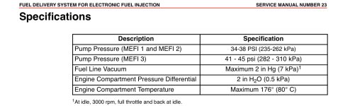

The engine had two possible fuel pressure specs I’ve attached.
when the key is turned on it would jump to 45 and settle at 41. Turning the key off, sometimes it would hold pressure solid for many minutes. Occasionally it would plummet right to zero.
Running, the pressure was 36-37. I did not test it by removing the vacuum from the cool fuel regulator.

The issue you are having ime has never been a fuel pump issue, pressure yes. In most cases the solution is a regulator. There have been a few changes to the design of the fuel supply system for 7.4L MPI engines. Most have at least two regulators. You need to check fuel pressure with and without the vacuum line(s) connected. This will inform you the regulator(s) are working or not.
My WAG rn is based on info provided you have either an injector issue (control or mechanical) or a damper/regulator issue. Damper being located somewhere on the fuel rail
