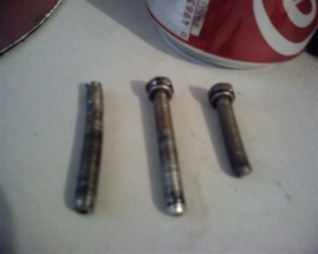

I dont think these are stainless... they appear to be the original parts (like most the parts in the engine...) they were super easy to snap. I snapped it with light pressure from my hand (using a socket wrench). on the bright side I only have to get out one bolt by drilling...
not sure if this helps but the head of the bolts are all stamped "SEMS"

the bolt on the left just the head snapped. the one thats still in the motor is the one on the right, it is about the same length as the one in the center.

sure got a warp to them bolts, lol.
look like regular steel. if u have to drill, follow the instuctions for stainless and use good bits. use bit and easyout size that shouldn't come clost to threads. best to run a tap through after and clean threads. problem is steel bolts in alluminium causes a reaction and they rot out unless pipe dope used on installation

ah, so it is steel. they seamed too weak to be steal but I didn't know about that reaction...
