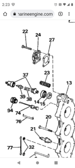

Pump kit 432955 was installed ???
Is something supposed to attach to those threads on the thermostat? Little confused. Also boats.net shows a pressure relief spring? Not sure what that's about thank you

This is the breakdown I get and I get a different part number for the t-stat. 434137

I can only suggest kit from factory.---0432955----Comes with instructions.-----Good luck with your motor.
