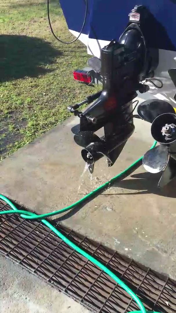

How can I tell old from new. I will take some pics and do some research. In the mean time I had to crank one up and smell some fumes. Impeller is working. Shifts forward neutral reverse neutral smoothly. Unjoints don't make excessive or weird noises when I move the leg left and right and up and down by hand.
