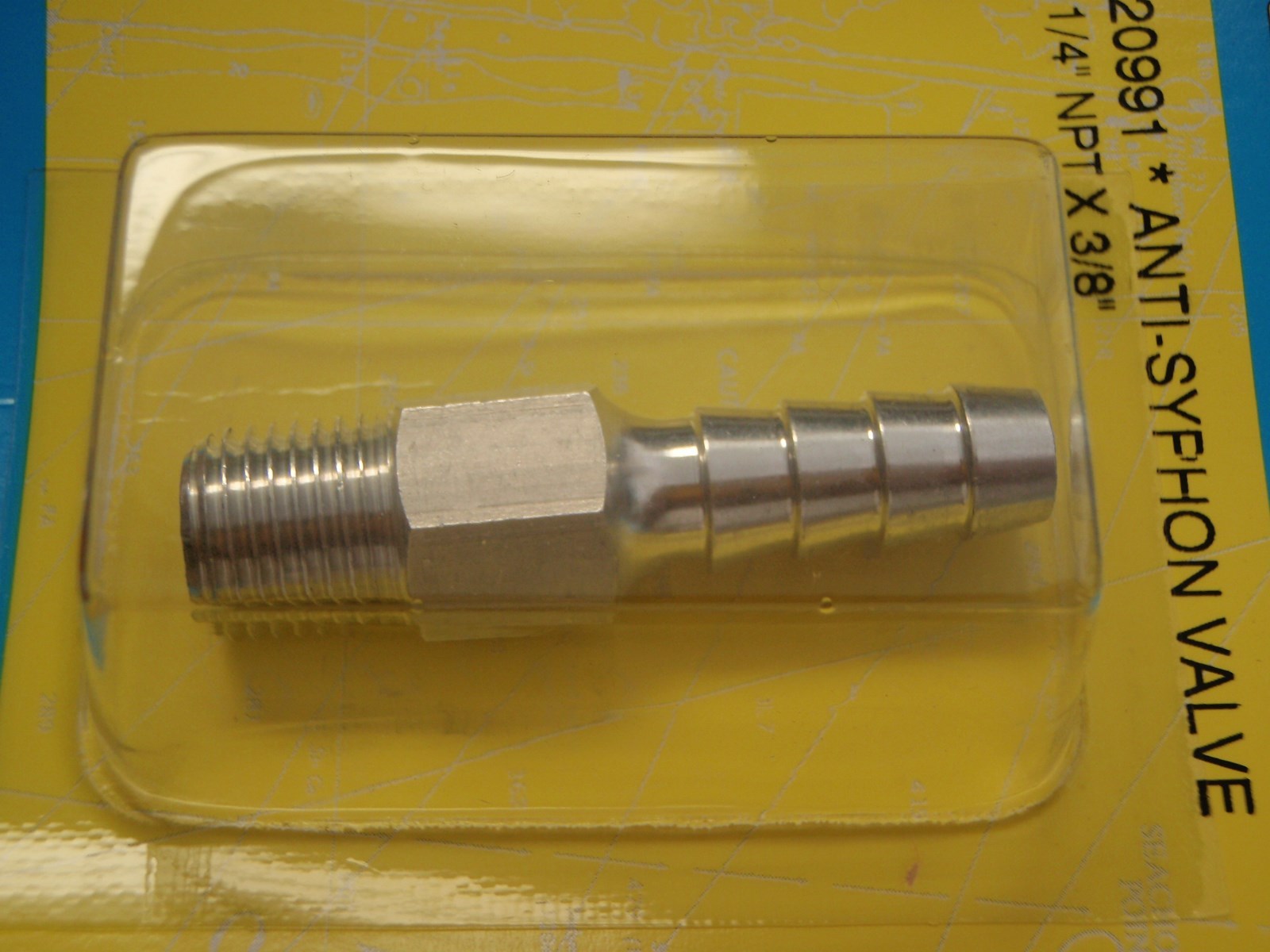

See if this picture attaches. Something like this at the shut off valve so one engine doesn't try and pull from the other?
Yep, That's what I was asking. They are there to keep fuel from spilling into the bilge in case of a leak. My boat has twin 5.7 Crusader's and I have was having fuel issues like you are describing. The Anti Siphon valves were the culprit.
Found this out after rebuilding the carbs twice, replacing fuel pumps, filters, lines. Was in the process of replacing the main lines from the tank to each motor. when we found them. Took them off to test and problem went away. It doesn't take much for them to fail. I keep several set of spares on the boat now.
It's possible you could have debris in the valve that is not allowing it to open all the way.

Ok I don't have any anti syphon valves on the system yet but I did order 2 of them. I will pull everything and check for trash. The fuel tank and lines are all new not that there still couldn't be trash in a new tank, fill hose or supply hose.

Nurse that is what I was thinking until yesterday after going from the city marina out to the gulf and back twice and that's a 3-4 mile run one way at 2800 RPMs and not even a hiccup from either engine. Here's my theory right now and I didn't get a chance to work on the boat yet, anyway. The fuel pump that was on the starboard engine when it quit is now on the port engine when it quit there after working for the day. Than I think since I don't have any anti siphon valves it sucks air from the side that quit working and the engine had enough fuel in the carb bowl to get me back to the dock before it went dry so let me buy one pump and replace the one on the port engine and install anti siphon valves on both engines. I think that will solve these gremlins.

Agree you want the antisiphon valves on, but the valves due create a bit more restriction for the pump to pull through

Yep they should be here next week and for now what I did was buy one automotive fuel pump for $16. I know you aren't supposed to use them but it was a cheap way to diagnose the issue. I also had a in line anti syphon valve so I stuck it on the port side. So after I installed new fuel pump on the engine that quit first that I think has the bad fuel pump it cranked up pretty quick and ran perfect. The other engine also cranked up after a few minutes of cranking and priming the carb. Ran both on the hoses and perfect. Took it back out to the Bay and they ran great so loaded everyone up and headed back out. Ran it out to the gulf again and again it was flat enough to anchor on the gulf side and enjoy the secluded beach for a couple of hours than ran back to the jetties and there was about a dozen Dolphins showing off for the group gathered there on charter boats, private boats and the dozen or more jet skis. Kids had a blast and Dolphins love to stick their heads out of the water near the boats and the kids and tourist scream and yell and oohhh and aaww which the Dolphins react to. They like being around people as much as we like being around them. Than took a run in the Bay for sight seeing and exploring. Boat engines have another 3 hours on them and no issues this time.
