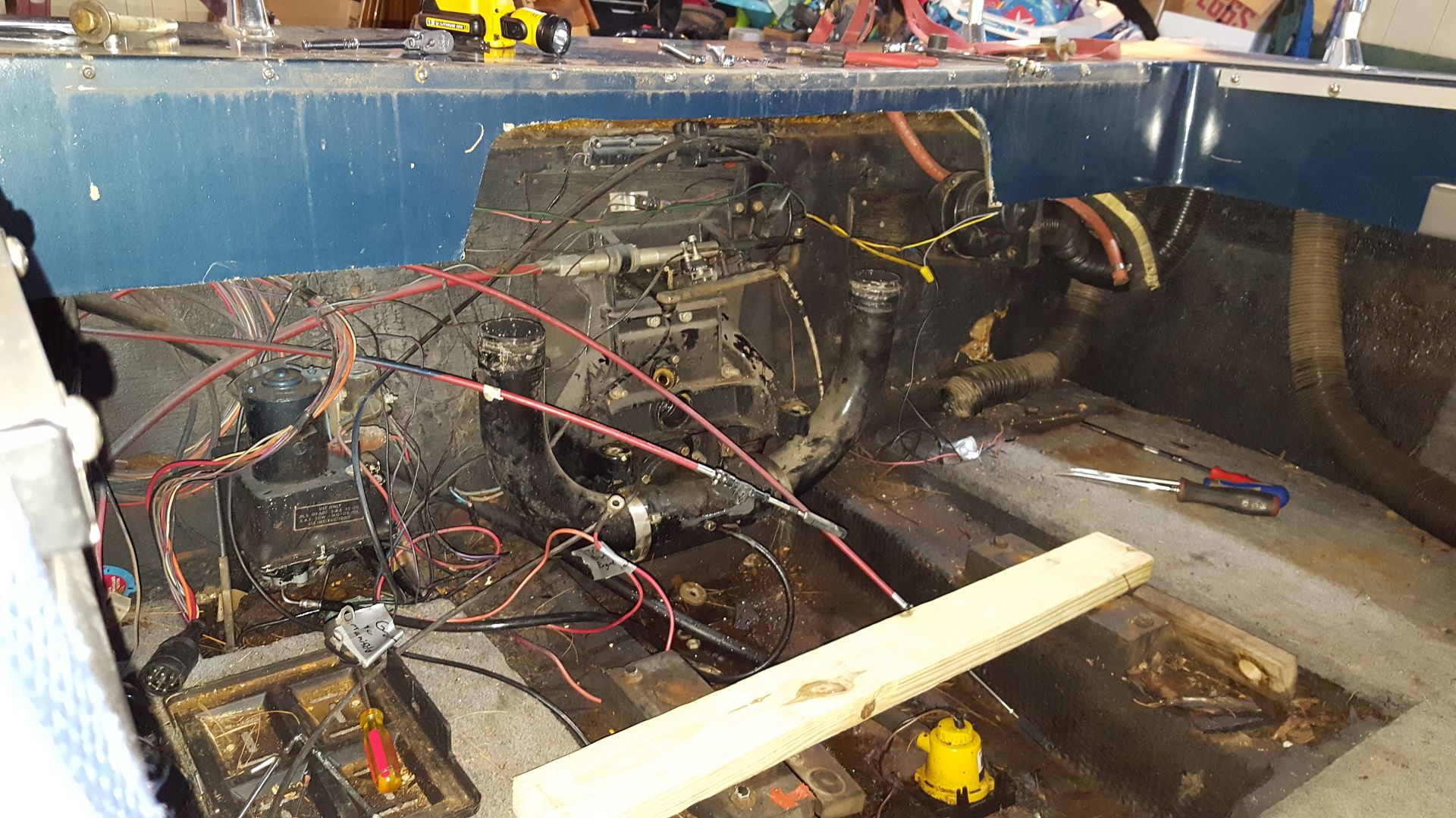

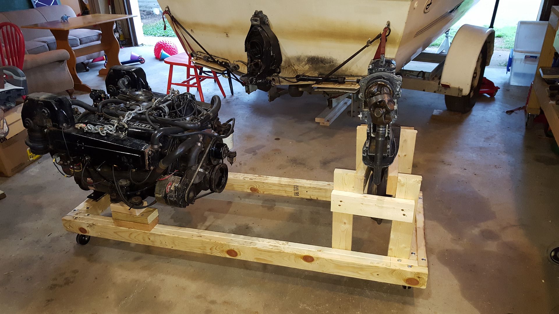

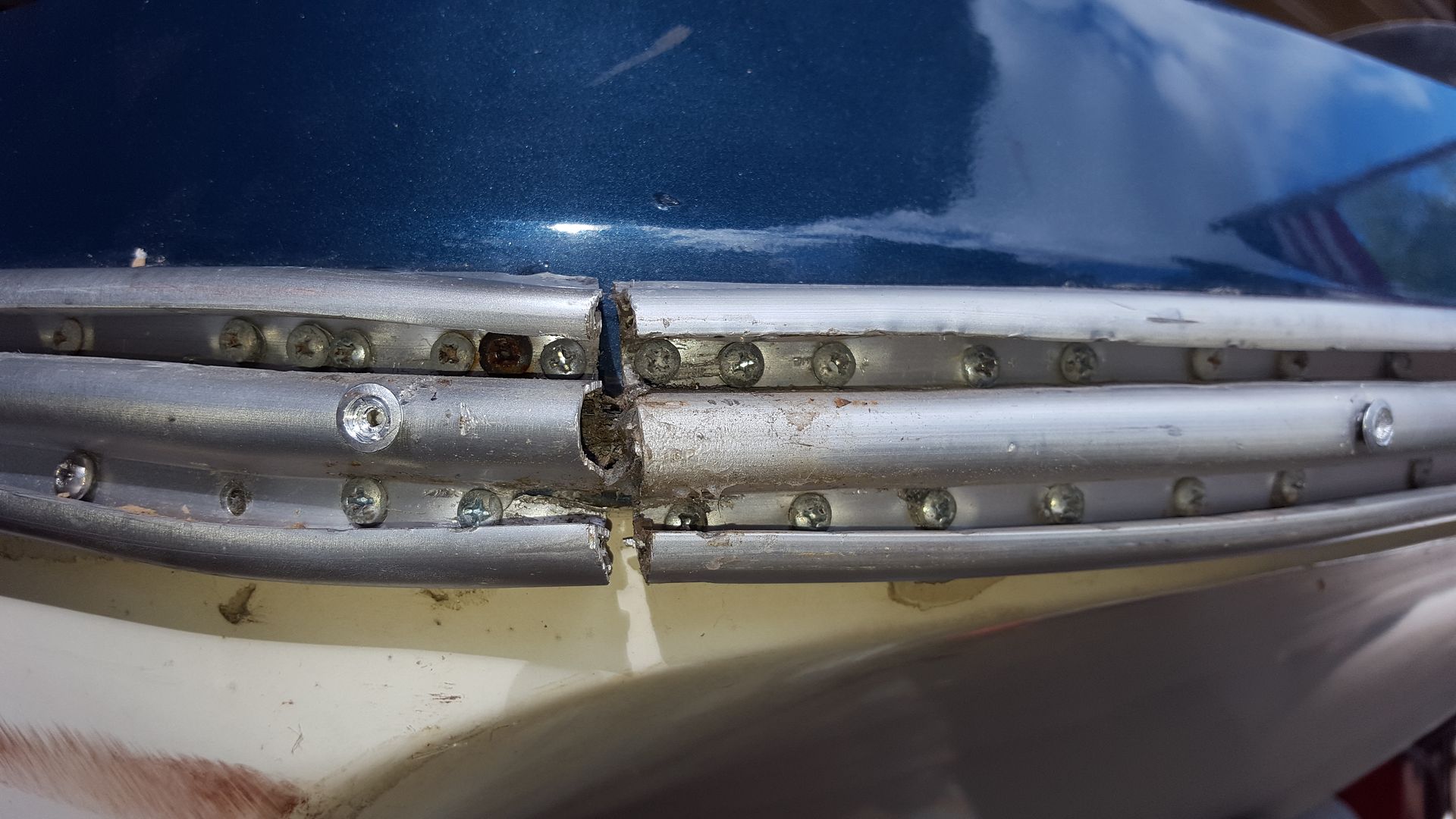

Hi all, I finally started tearing down my boat to replace the stringers and rotten transom, ive been taking pictures and video (cell phone😒) and if anyone has helpful suggestions and constructive criticism by all means please share.
First picture is the engine on my stand along with the outdrive
Engine compartment after engine was removed
Last picture for now if the rub rail on the front corner, I'm hoping that's not oem but it also makes me nervous what else I'm going to find
