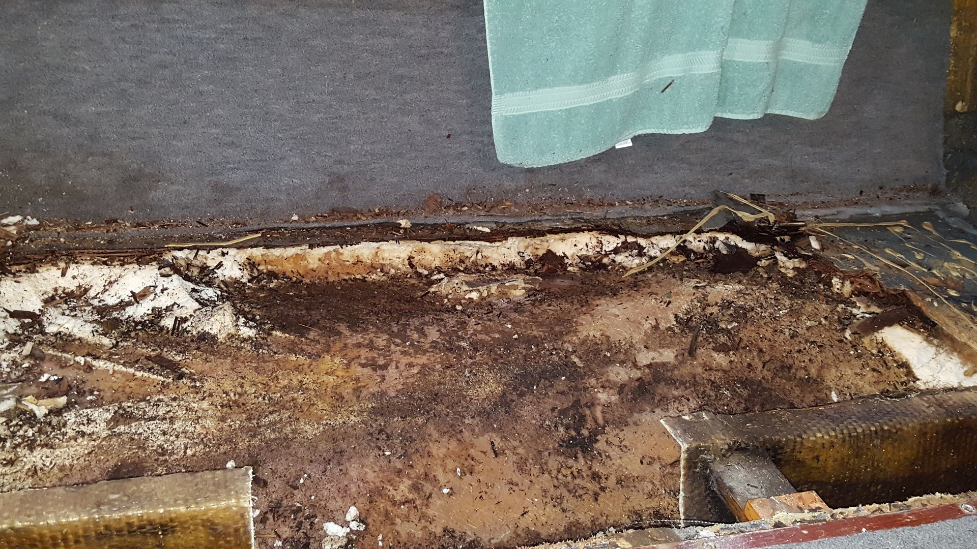

Well I assumed it would be rotten but there was never any wood it looks like they ran a 1x4 from the rear bulk head forward to use to attach the glass to which made a container to pour in foam, I had always assumed all boats had wood stringers, it will when I'm done anyways I guess.
I would say you have a good plan for the repairs. Make sure you take lots of pictures and post them along the way. We love pictures and it also helps you see your progress along the way as well. And if you ever plan to sell the boat, you can show the perspective new owner exactly how the boat was rebuild. That would make a sell go so smoothly. :thumb:

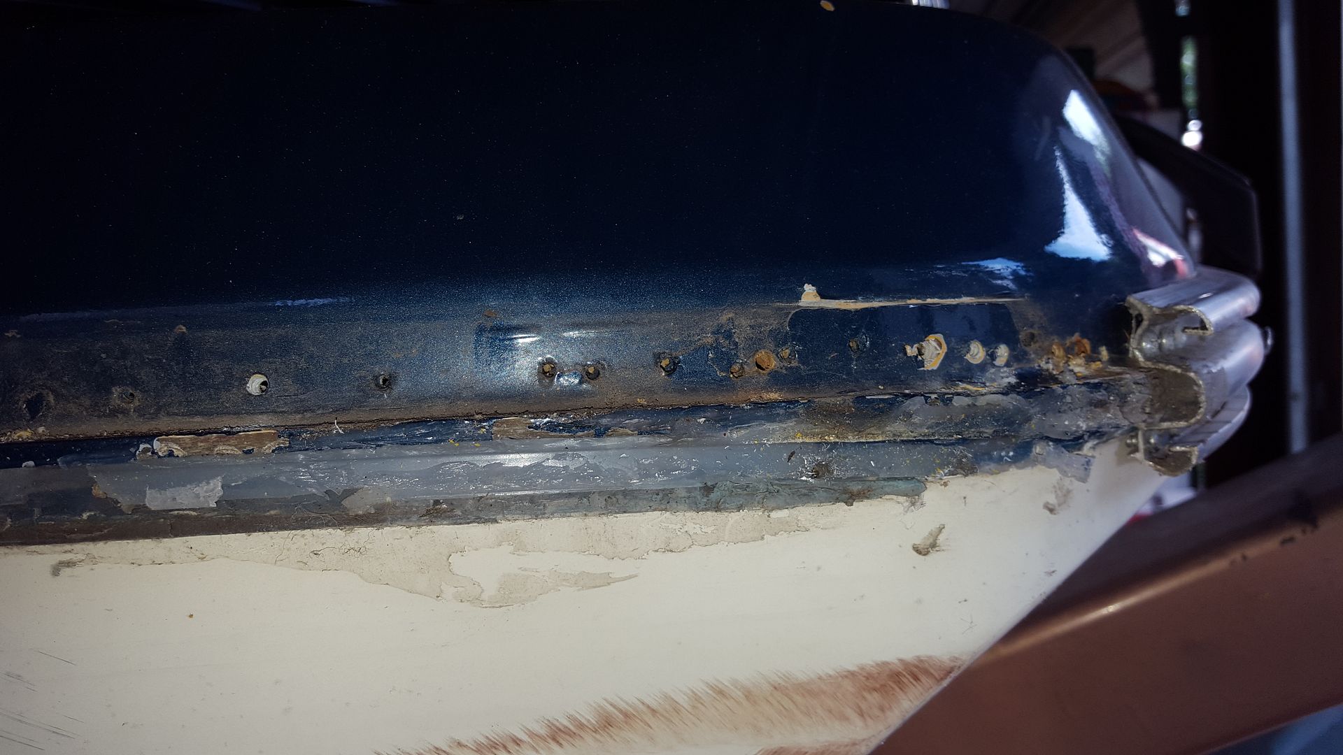

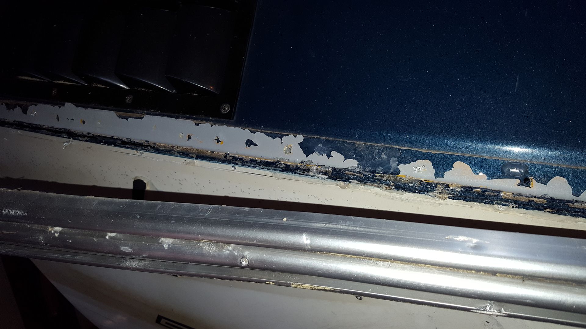

Well I got some more foam out , ran out of room in the garbage so moved onto removing the rub rail. Who ever put this on last used a really strong silicon adhesive, pulled] a lot of the paint off

Yea, it happens like that sometimes. But you were planning on refinish the hull anyways weren't you? So all that paint would have to come off anyways. If you simply feathered the paint and painted over that, it wouldn't be long before it would come off again. So you will have to sand that loose paint off before refinishing. That is exactly what I am presently doing to my hull, sanding and prepping for hull filler and primer. As for filling up the garbage container with rot and soaked form, I know all about that as well. We, wife and I, remove a lot of very heavy soaked foam from my project boat initially. I wish I would have weighed it because it was a lot of weight. It took more then a few garbage containers to hold all of it. Just think how much lighter and solider your boat will be when finished. That equates to a faster hotshot, less gas usage, and more performance as well. And all that is a good thing too. JMHO
Oh, while I am thinking about it. Try your darnedest to scrap off as much of that silicone adhesives as you can before sanding. That stuff plugs the sandpaper really quickly.

Roger that on the silicon removal. The foam isn't as saturated as I was expecting. So here is a crazy question, how do guys replace just part of the transom, since this boat doesn't have stringers I'm trying to see if I could get away without pulling the cap, thinking of running the stringers from transom forward as far as I can get and then tie into what's there now and then replace the bottom half of the transom. What are your guys thoughts on this?
My personal opinion. I would replace the entire transom if I were doing it. WHY? Because trying to replace a portion is more effort then it is worth. And the partial replacement will never ever be as strong as one solid piece. But that is just my opinion.
Yeah, I figure on doing just that. If I tried going partial I know I would get it apart and end up doing the hole thing anyways, might as well go all in
