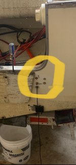

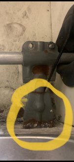

Anyone have experience with this steering cable/linkage support? If i can avoid putting the holes through the new transom i will. Would love to just fill those old holes in. Will it be strong enough if i install this with stainless lag screws from the inside instead of bolts that go all the way through?
Steering through the tilt tube is my preference.
Your style would be unsafe if the transom bracket came loose at high speed. Lag bolts may not stay tight.
Is this outboard missing a tilt tube or is the cable too short? Curious why this style was used.
I had that same setup on my Kingfisher for the old style pulley and cable steering system. I trashed that and switched to the modern setup. Filled the old holes and moved on.
39,646
The steering on a 1974 model Evinrude hooks up to the tilt tube.--------There should be no need for that adapter bracket,-------That bracket was used for Evinrude motors 1972 and older !
Now thats something! Im pretty sure mine is a 74. Ill take a better look and get back to you. This would be great news if i can just forgo reinstalling it.

The cowling / decals on the motor in the pictures indicate a 1974 model.
Here is what ive found. The steering was connected to an arm in front of the engine with a bolt. Ive also attached the model plate which im assuming has a date indicator number on it.

Your old cable has extra pieces on the end to be removed. Then make sure the cable is long enough to thread in the tilt tube.
If that all works out you need a rod to connect the cable to the hole in front of the motor.
