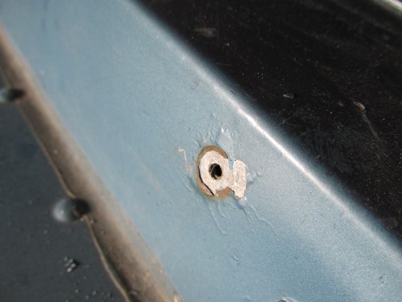

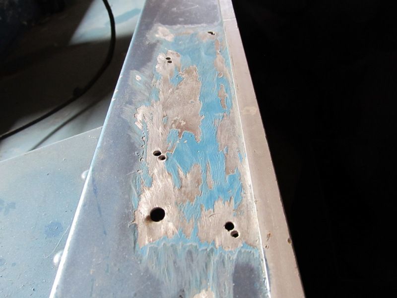

Here are some pics. Always seem to help clarify the issues. This is the cross piece at the front of the splashwell. Not huge areas to warrant total replacements. Small snap screw holes Ive done with JB Weld and my high build primer likely covered well. The 3M looked good price wise but its appears to be single use filler and hardner pack for a one shot application.

I hate to say this but that's nothing! Here's a look at the Swiss cheese gunnels of my Chief, over 70 some odd holes in each gunnel I had to repair, repaired and then primed.

No offense taken Watermann. I know its minor but sometimes its only a little more effort to do it right and avoid the loss of a bad repair and starting over. So you repaired them rather than replace. Did you use the 3M? I might try mixing 50% at a time. Take it down to bare metal and rough it up for a good bond.
What ive done for small holes is back them with aluminum held in place with Gorilla Tape. Then patch with JB Weld and force enough through to mushroom out on the back side and they have held up. I later remove the tape. Just no experiece with anything bigger than 1/4 inch holes.

No offense taken, it takes way more than an internet forum to offend me and everyone has their opinion. :lol: I try to only listen to the guys who've actually done it not just read about it. I thought you were wanting to fill a a larger area not just smaller holes like in your pic. On big holes you need a backer plate to help support the repair.
For smaller holes it's easy but for large areas of mauled AL you would have to use some sort of filler, personally I've only used marine tex to fill larger areas rather than the 3M filler. I filled a crease in the bow of my Chief. But on all those holes I used JB water weld 2 part epoxy sticks. Made a wad filled the hole so it would form a mushroom on the inside and then once set up sand it smooth. The mushroom and thicker stick JB means no need for a backer plate to keep the gooey stuff where you want it.
