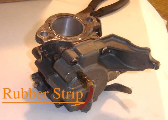

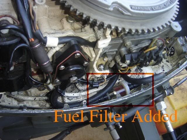

I found the problem, it's that long piece of rubber stuck in the fuel line and another piece that was sucked up into the needle seat. I don't know where in the world these came from, they were thin red ribbons of rubber. Looks like gasket material from somewhere maybe the fuel pump. I went ahead and rebuilt the carb, got it all back together and she runs great! I added a fuel filter between the fuel pump and carb (See photo) to try and keep anything else from being sucked into the carb. This is a fuel filter I had laying around the shop, I think it came off a 4 stoke gas engine. My question is will this filter be Ok to use on the 2 stroke motor, I don't want it to filter all my oil out of the fuel. Is this filter Ok or should I get one made for an outboard?
