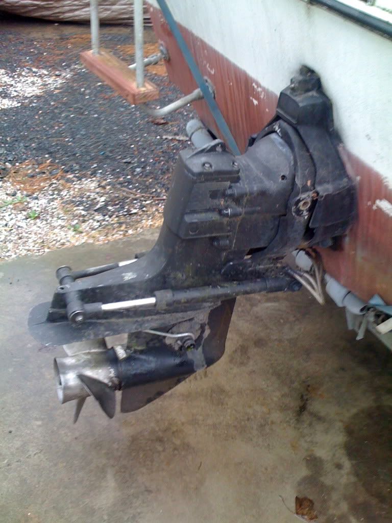

alright guys got out and checked out the boat today and she was solid as a rock! guess the starter solenoid went bad or the switch cause she wouldn't crank over with the key. so we hooked the starter up directly to a battery and she turned but didn't start the plugs are bad most likely... she deff needs some work but for 500 bucks i think i got a deal. all the floors are good and the hull is solid just really really dirty and the interior is shot. gonna try and tinker with it this week pull the solenoid off and order a new one and see if that was it. and get new plugs wires and a cap. but heres some pics of the boat.

Well she's definitely a bit rough, but if you can get her cleaned up and find all of the bits and pieces, you'll have a good boat. It looks like the outdrive has been spray painted to me, and is it me or is the starboard side of the outdrive missing the pin for the gimbal housing?

yes it is missing is that a critical part for the outdrive for cooling or anything of the sort?
