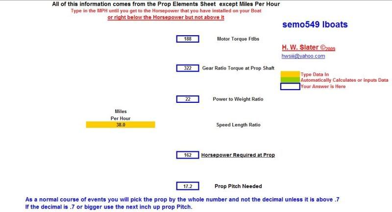

Semo, junior is definitely right your rpm ought to be close to max with a 17" pitch at 4,600 RPM. It will help your hole shot a lot, get rid of the hydrofoil if you still feel the need to have something for stern lift buy some smart tabs sx they are only about $ 130. Here are my numbers.
Prop Picker
