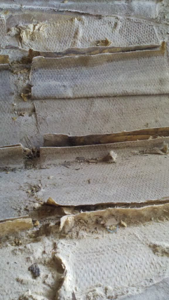

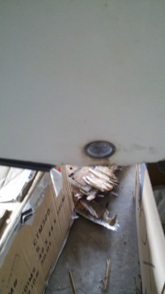

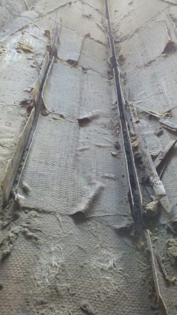

whats up guys? Having some time off work, I was able to work on my 77 American and I got the stringers out. My question for everyone is I have old fiberglass mat still attached, some wavy and some not. I know i have to remove the wavy old mat but the mat that is still laying flat do I have to remove it? Also, ehat is the best way to remove the old drain plug? Thanks guys.

I'd cold chisel break those wavy areas and grind down what doesnt break out. The old mat..that would stay.

The 'old' flat glass mat can stay, if it's well stuck. But you will need to make sure you clean it very well & wipe it down w/ acetone to make sure there is nothing left on the surface of the waffle texture that would hamper the new materials from being well adhered. And yes, all those areas that look like ripples across the water will be in the way of a good, solid, air bubble-free & well stuck fiberglass tabbing to reinstall your stringers.
You should also remove the 1" lip left behind when you removed the stringers.

Yep, you'll want to remove the lumps, and at the very least you should do a ruff-n-scuff on the glass mat you leave behind to insure a goob mechanical bond between the old and the new...and like jbcurt said, wipe down real good with acetone right before apllying the new glass...

You can remove the old drain plug by any method you desire except to try and get it out in reuseable condition...you can use a punch and cave in the edges, then knock it out...it will be getting replaced with a new one once you get your new transom in...
