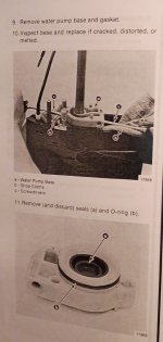

1978 Mercury 70hp - Serial # 4979486
I'm trying to figure out how to remove the water pump base so I can replace the seal around the shaft.
Chris1956
Honorary Supreme Mariner
Mar 25, 2004
29,283
Use two wide screwdrivers to pry it alternatively straight up. The friction of the oring seal is the only thing holding it in.

Okay, I started with a couple flat head screwdrivers, when it resisted, I figured I had better ask here.
Berdink
Mar 5, 2020
572
Yes, mine had a gasket also.
Using a couple flat head screwdrivers with more force got it.
Thanks!
