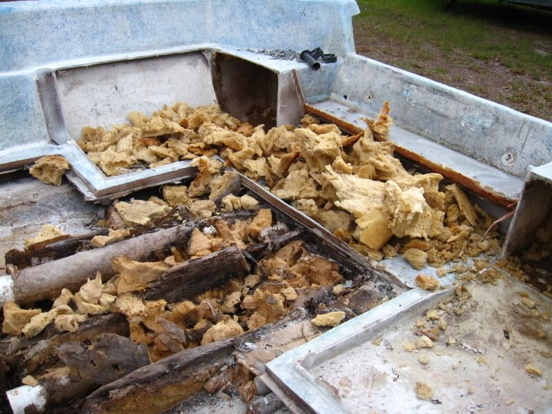

Well after a day of being out of the hospital for the weekend I just relaxed and enjoyed my house. Today I had lots of yard work to do and then the wife alowed me one hour to work on the boat, so I started cutting out the rear baitwells as fast as I could. I was then slapped in the face by a solid block of saturated foam. I knew it wasnt pretty when I began to cut the last wall before the transom and water began to literally pour out as I cut. Once off, I started ripping out the foam and a waterfall of water came out.
I still have foam right at the last portion of the center stringer, but after digging this garbage out I was done.
I have learned something so far. Wet foam is easier to remove than dry, atleast for me. The wet comes out in big chunks where the dry breaks apart.
