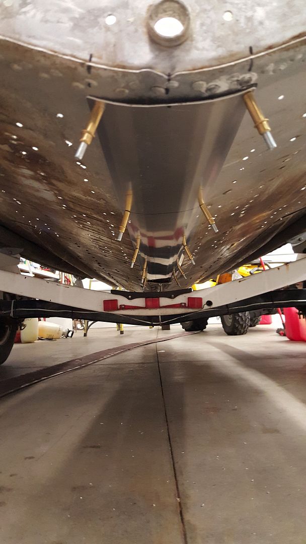

Hey ford290, I was blown away when i saw them. I knew the guy had a few over the years but had no idea he was keeping to rebuld some day. there were three of them back there. all three were blocked up off the ground, not on trailers. my ribs do have a small amount of space under them, so the water does flow back. i would guess it was intended to be tight as some of mine have fair sized gaps and not all gaps the same. you can see in this pic if you zoom in. . you can see i have a few dents in the bottom. one deep one that in right under the short rib that goes between the ib engine mounts. i dont dare try and work it out for fear of a crack due to metal fatigue from trying to remove it. so instead i fabricated a doubler to go over the keel in that area to ensure the water is flowing a bit smoother back to the prop, and as a reinforcment in case it does take a hit again.

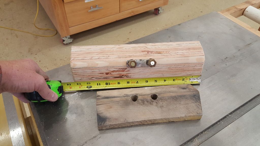

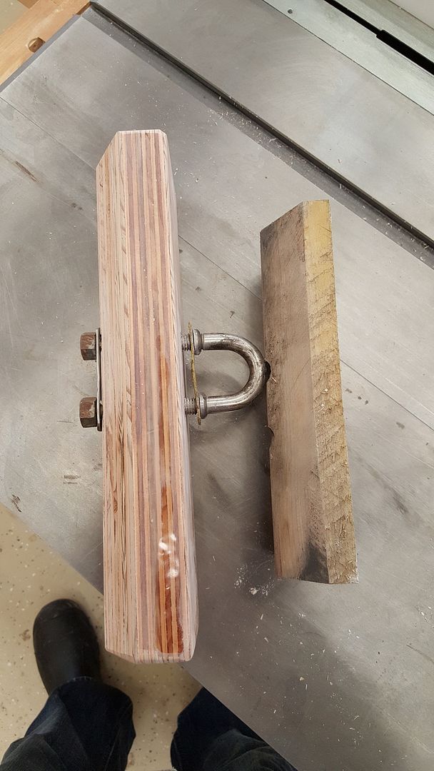

I made up a new block for my bow eye. the old one was cracked, maybe from age? anyway made the new one from 3 3/4 pieces of plywood epoxies together. still need to epoxy it. made it 4 inches longer and 1/2 inch thicker. should be much stronger and more bearing surface.
what are the line up tools called that you have hanging off the plates you are planning to rivet???

Good idea with the bow eye backer replacement and that extended keel shield should do the job nicely! Looking super on the hull repairs :thumb:

Bob, i think you are asking about the cleco's. Great to have when working with rivets.
thats it, clecko fastners. great tool and cheap. made in all sizes that rivits are available. they will hold your pieces very tight while working. i used to be a aircraft mechanic and we used them extensively when working with sheet metal. cheapest place ive found them is aircraftspruce.com
